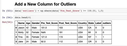

Additionally, what you could do is create a new column and label outliers as 1 (otherwise 0). This is a technique used in Kaggle competitions.Add a New Column for Outliers
The idea is to make it easier for the algorithm to detect patterns. A decision tree might detect faster a pattern if you feed him 1/0 for outliers.
How do you define outliers? Difficult question, but you could use IQR * 1.5.
