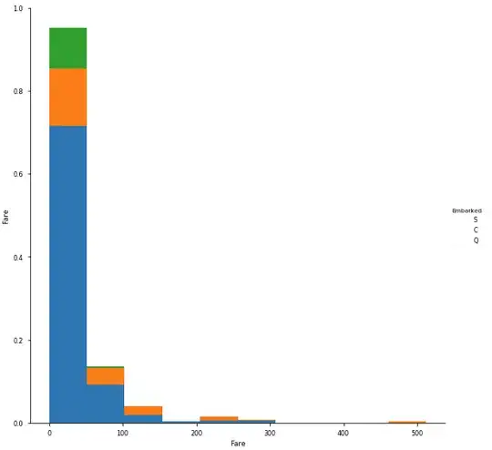

It seems like PairGrid is almost what I want, but it appears to be giving some strange axis for "Fare" (which is not between 0 and 1), and the legend is blank, and the colors are solid (so you can kind of only see the top layer).
g = sns.PairGrid(train_df[["Embarked","Fare"]], hue="Embarked",size=8)
g = g.map_diag(plt.hist)
g = g.add_legend()
