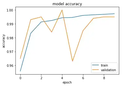

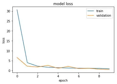

history = model.fit(x_train, y_train,
          batch_size=batch_size,
          epochs=epochs,
          verbose=1,
          validation_data=(x_test, y_test))
Epoch 10/10
100000/100000 [==============================] - 6s 56us/step - loss: 0.9061 - acc: 0.9973 - val_loss: 0.5302 - val_acc: 0.9950
