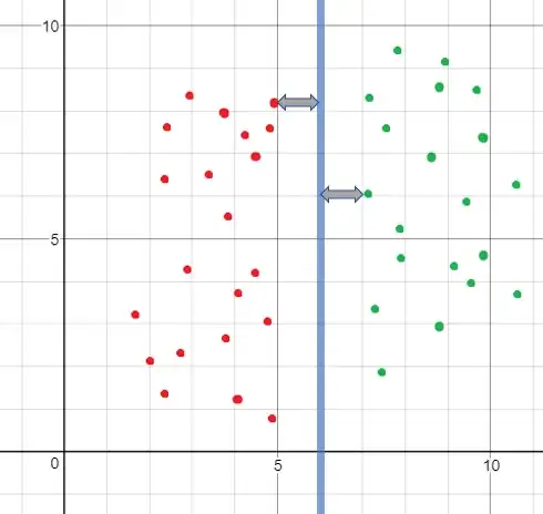

By the way, I was disappointed to find out that choosing $\bar{\theta}$ such that $\left \| \bar{\theta} \right \|=1$ doesn't give the $\gamma$ you would have expected from looking at the examples and the hyperplane in a graph. e.g.:
margin example
The hyperplane in the graph is the line $x=6$, and for $\bar{\theta}= \left(\begin{gathered}1\\ 0\\ -6 \end{gathered} \right)$ we would get $\gamma=1$, which fits the geometric intuition. However, $\left \| \bar{\theta} \right \|\not=1$ in this case (because of the trick of putting the bias inside $\bar{\theta}$).
For $\bar{\theta}= \left(\begin{gathered}\frac{1}{\sqrt{37}}\\ 0\\ -\frac{6}{\sqrt{37}} \end{gathered} \right)$ it holds that $\left \| \bar{\theta} \right \|=1$, but $\gamma=\frac{1}{\sqrt{37}}$.
