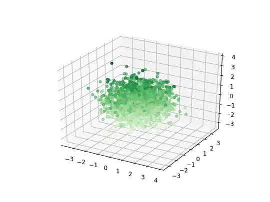

I am trying to visualize above simulated samples (x_data and y_data) using matplotlib. I was able to plot x_data as displayed in following image. I would also like to visualize simulated results (y_data) on this plot, may be with a different color. Motivation behind it is to visualize relation between x & y. How can I plot it so?

Here are how sample data is displayed by above sample,
synthetic data samples

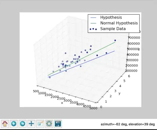

Here is an example of what I would like to achieve. The image shows two different hypothesis represented by straight lines, in my case I would like to draw a single line representing y_data.
Example from Web

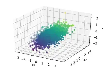

For your exemple, that would mean plotting independently for (X1,X2), (X2,X3) and (X1,X3):
ax.scatter(x1, x2, y_data[0], c=y_data[0], cmap='viridis');

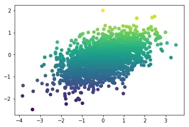

To be honest, this is not ideal as some point may recover others. This can be adressed by adding some transparancy to the points (parameter alpha), but it doesn't improve the visualisation that much. I would recommend to start with 1D plot (y against another variable), to really understand what is happening:
plt.scatter(x1, y_data[0], c=y_data[0], cmap='viridis');

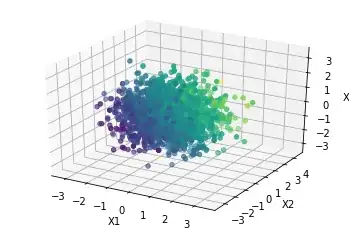

2. Use color and make the graph interactive
One way to add a 4th dimension to graph is to make the use of color. It has some limitations (you need a good color scale : one that would still render if printed in B&W, one that is color-blind friendly). Indeed, It won't apply to more than 3 variables.
For your exemple, that would mean something like :
ax.scatter3D(x1, x2, x3, c=y_data[0], cmap='viridis');
This faces the readability problem as above (but I find it better as the colour bring some information instead of repeating what is on the vertical axis).

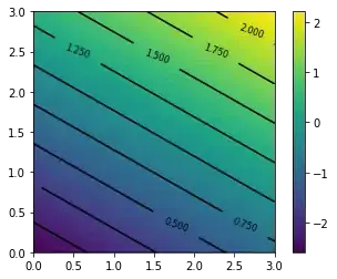

Plot the output and associated contour :
contours = plt.contour(X1_plot, X2_plot, Y, 20, colors='black')
plt.clabel(contours, inline=True, fontsize=8)
plt.imshow(Y, extent=[0, 3, 0, 3], origin='lower',
           cmap='viridis')
plt.colorbar();
You get a graph with different value of y for X1 and X2. The main drawbacks are : you don't see the interaction with X3, you have to set a given X3 (0 here). Meaning that you have to plot similar graphs with (X2,X3) and (X1,X3), plus you have to make the set aside variable move to value other than 0. Even if this could be automated, it can rapidly be a pain with lots of variables.
