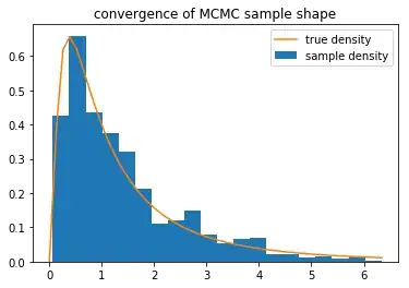

You see that the results are not very close, but with longer sampling (1000 points is too few) they will converge. And the shape of distribution is already well matched:
plt.hist(sample, bins=30, normed=True)
idx = np.linspace(0, sample.max())
plt.plot(idx, scipy.stats.lognorm(1.0).pdf(idx))
plt.legend(['true density', 'sample density'])
plt.title('convergence of MCMC sample')
plt.show()
