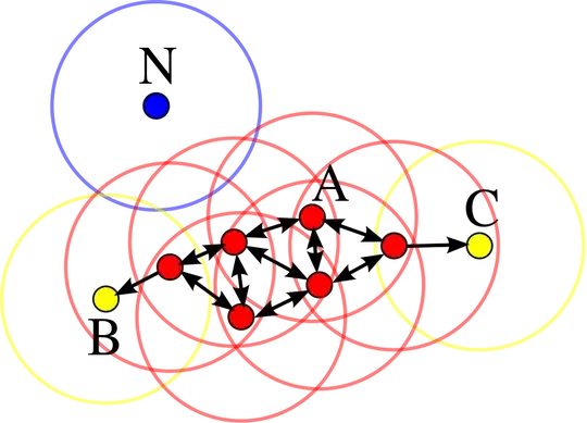

If your Data points are dense and noise points are away from the dense region, you can try DBSCAN algorithm.
Tweak its parameters until u get a best fit.

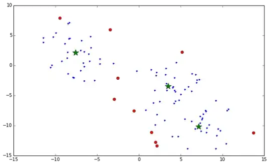

  1. Apply your clustering algorithm
  2. Calculate distance from all data points to its assigned cluster
  3. Label the data points furthest from a center as an outlier
Randomly generating 100 data points from three gaussians, clustering them with k-means, and marking the 10 'furthest from a center' data points gave the following graph: enter image description here
see this notebook for the full example
The burden of solving what "distance" means will already have to be solved for you to run a clustering algorithm. It will still be up to you to pick off what distance means an outlier. In this example, I just picked the N most distant data point, though you'll probably want to pick any number of data points over a certain number of standard deviations from a center.
