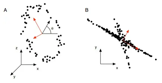

Edit: to give more info, in the tutorial, page 12, the author gave an example of non-Gaussian distributed data that causes PCA to fail.

In page 10 Shlens gives an example for when one might see the result of PCA as a failure, and then explains why PCA didn't really fail:
The solution to this paradox lies in the goal we selected for the analysis. The goal of the analysis is to decorrelate the data, or said in other terms, the goal is to remove second-order dependencies in the data. In the data sets of Figure 6, higher order dependencies exist between the variables. Therefore, removing second-order dependencies is insufficient at revealing all structure in the data.
Figure 6 - examples for when one might think that PCA failed
i.e. PCs are guaranteed to be uncorrelated, so that's exactly what we should expect them to be. However, if we expected the PCs to be independent, then we would consider PCA to fail when the PCs aren't independent (e.g. the examples in figure 6).
(See this answer for another explanation of this paragraph.)
