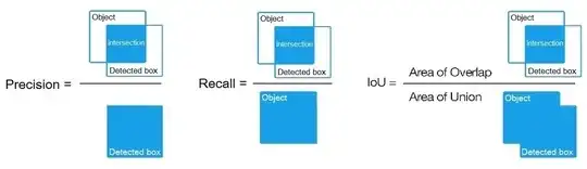

  • C) Or for many different thresholds of detection algorithms we calculate:
    Precision = Intersect / Detected_box
    Recall = Intersect / Object
    As shown here? enter image description here

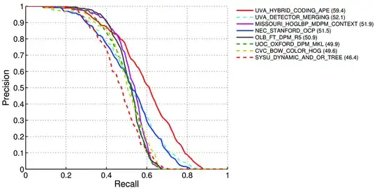

  1. Then we build Precision-Recall curve, as shown here: enter image description here
  1. Then we calculate AP (average precision) as average of 11 values of Precision at the points where Recall = {0, 0.1, 0.2, 0.3, 0.4, 0.5, 0.6, 0.7, 0.8, 0.9, 1}, i.e. AP = 1/11 ∑ recall∈{0,0.1,...,1} Precision(Recall)
