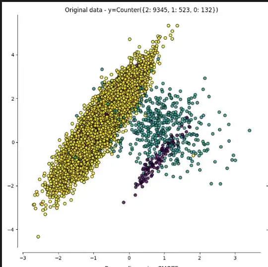

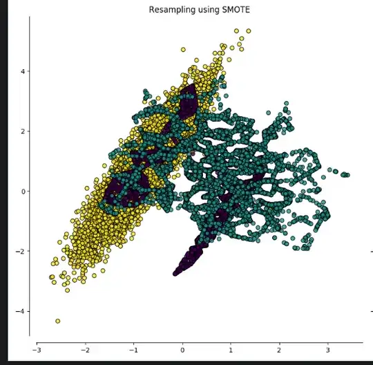

The SMOTE implementation provided by imbalanced-learn, in python, can also be used for multi-class problems.
Check out the following plots available in the docs:
Also, the following snippet:
