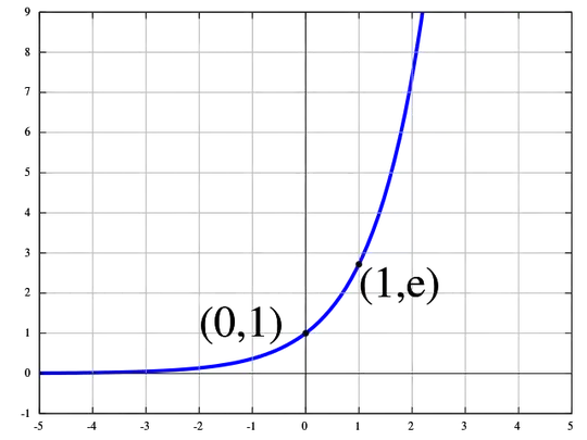

  3. Now I get to your question. The $e$ in softmax is the natural exponential function. Before we normalize, we transform $x$ as in the graph of $e^x$:
If $x$ is 0 then $y=1$, if $x$ is 1, then $y=2.7$, and if $x$ is 2, now $y=7$! A huge step! This is what's called a non-linear transformation of our unnormalized log scores. The interesting property of the exponential function combined with the normalization in the softmax is that high scores in $x$ become much more probable than low scores.

That's much closer to the argmax! Because we use the natural exponential, we hugely increase the probability of the biggest score and decrease the probability of the lower scores when compared with standard normalization. Hence the "max" in softmax.
