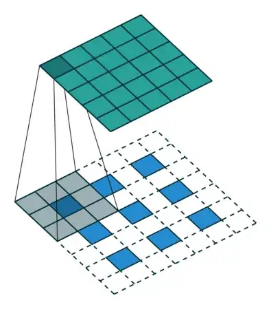

Fractionally-strided or transpose or "deconvolution":
This sort is very much still convolution at heart. The difference is, again, that we will be moving from smaller input volume to a larger output volume. OP posed no questions about what upsampling is, so I'll save a bit of breadth, this time 'round and go straight to the relevant example.
In our 9x9 case from before, say we want to now upsample to 11x11. In this case, we have two common options: we can take a 3x3 kernel and with stride 1 and sweep it over our 3x3 input with 2-padding so that our first pass will be over the region [left-pad-2:1, above-pad-2: 1] then [left-pad-1:2, above-pad-2: 1] and so on and so forth.
Alternatively, we can additionally insert padding in between the input data, and sweep the kernel over it without as much padding. Clearly we will sometimes be concerning ourselves with the exact same input points more than once for a single kernel; this is where the term "fractionally-strided" seems more well-reasoned. I think the following animation (borrowed from here and based (I believe) off of this work will help to clear things up despite being of different dimensions. The input is blue, the white injected zeros and padding, and the output green:
transposed conv, input is blue, output green
Of course, we're concerning ourselves with all of the input data as opposed to dilation which may or may not ignore some regions entirely. And since we're clearly winding up with more data than we began, "upsampling".
I encourage you to read the excellent document I linked to for a more sound, abstract definition and explanation of transpose convolution, as well as for learning why the examples shared are illustrative but largely inappropriate forms for actually computing the represented transformation.

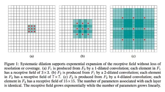

First we talk about Dilated Convolution
I found this nice blog on above topic. So as I understood, this is more like exploring the input data points in a wide manner. Or increasing the receptive field of the convolution operation.
Here is a dilated convolution diagram from the paper.
Image 3
This is more of normal convolution, but help to capture more and more global context from input pixels without increasing the size of the parameters. This can also help to increase the spacial size of the output. But the main thing here is this increases the receptive field size exponentially with the number of layers. This is very common in the signal processing field.
This blog really explains what is new in the dilated convolution and how this is compared to normal convolution.
Blog: Dilated Convolutions and Kronecker Factored Convolutions

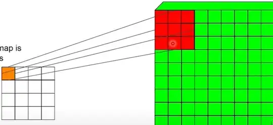

Now I will explain what is Deconvolution
This is called transposed convolution. This is equal to the function we used for convolution in the back-propagation.
Simply in backprop we distribute gradients from one neuron in the output feature map to all the elements in the receptive fields, then we also sum up gradients for where they coincided with same receptive elements
Here's a good resource with pictures.
So the basic idea is deconvolution works in the output space. Not input pixels. It will try to create more broader spacial dimensions in the output map. This is used in Fully Convolutional Neural Nets for Semantic Segmentation.
So more of Deconvolution is a learnable up-sampling layer.
It's tries to learn how to up-sample while combining with the final loss
This is the best explanation I found for deconvolution. Lecture 13 in cs231, from 21.21 onward.

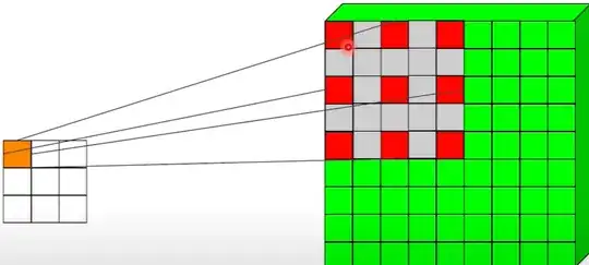

The crux of this question is to know more about dilated convolutions(I guess). So, I am assuming everyone is familiar with the normal convolution operation. I'll mention it very briefly down below.
Dilated/Atrous Convolutions
  • Useful when we want to generate output by looking at a larger field of view.
  • Extremely popular in the field of image segmentation.
  • Dilation is a process by which we increase the receptive field of the convolution(receptive field ~ Field of view). Original convolving filter : enter image description here
For dilation : just move each red block around the center by k-1 units away(if the dilation rate = k ) and fill the empty slots by 0.
  • Dilation rate may be varied accordingly to visualize larger areas.
  • Dilated convolutions support the exponentiation of receptive fields without loss of expansion/coverage.
  • Moreover, no additional computation resources are burned. There is no resolution loss unlike pooling and strided convolutions.
