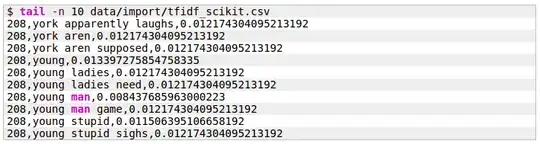

I see how to use TF/IDF to generate words and phrases from a corpus but output as expected is a list of common words and phrases along a flat dimension: enter image description here

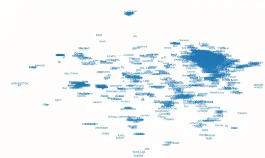

What I am looking for is something more along the lines of a high level cluster of vectors in space:enter image description here [source]
