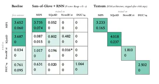

The paper deals with methods (models) for text summarization. The reference (base) model was "first sentence model":
As a baseline for our models we used a trivial model that repeats the first sentence of the input document.
Then, various experiments and results are presented, like this one: (notice that "first sentence model" is always present as "baseline")
Moreover, one of the datasets for training and evaluation of models in this paper is DUC, which may be interesting to you.

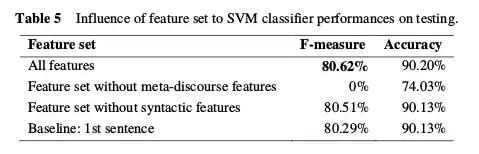

Khodra, Widyantoro, Aziz, Trilaksono (Journal of ICT Research and Applications, 2011)
Free Model of Sentence Classifier for Automatic Extraction of Topic Sentences
The author identifies and tests methods for identifying the most important sentences in a text (see list of 58 items below, called features). Surprisingly, in the conclusion, it is said that position of the sentence is a dominant feature, meaning that including all other features into consideration leads only to small improvement.

For you, the most important part of the paper may be table 5:
Read carefully the explanation of the table in the paper, and the whole Section 4.3.
