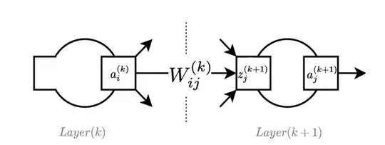

Image shows a typical layer somewhere in a feed forward network:
$a_i^{(k)}$ is the activation value of the $i^{th}$ neuron in the $k^{th}$ layer.
$W_{ij}^{(k)}$ is the weight connecting $i^{th}$ neuron in the $k^{th}$ layer to the $j^{th}$ neuron in the $(k+1)^{th}$ layer.
$z_j^{(k+1)}$ is the pre-activation function value for the $j^{th}$ neuron in the $(k+1)^{th}$ layer. Sometimes this is called the "logit", when used with logistic functions.
The feed forward equations are as follows:
$z_j^{(k+1)} = \sum_i W_{ij}^{(k)}a_i^{(k)}$
$a_j^{(k+1)} = f(z_j^{(k+1)})$
For simplicity, bias is included as a dummy activation of 1, and implied used in iterations over $i$.
