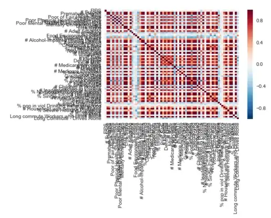

I create a corr() df out of an original df. The corr() df came out 70 X 70 and it is impossible to visualize the heatmap... sns.heatmap(df). If I try to display the corr = df.corr(), the table doesn't fit the screen and I can see all the correlations. Is it a way to either print the entire df regardless of its size or to control the size of the heatmap?

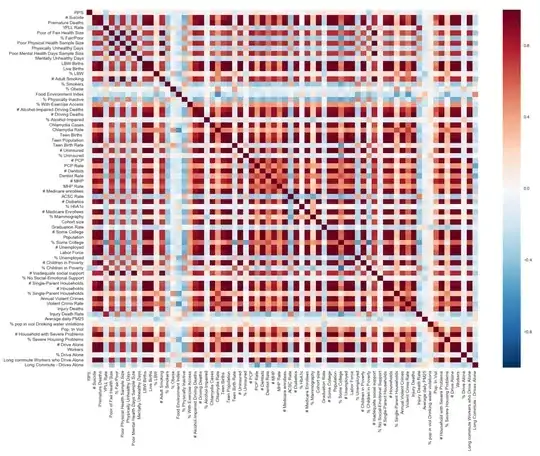

I found out how to increase the size of my plot with the following code...
plt.subplots(figsize=(20,15))
sns.heatmap(corr)

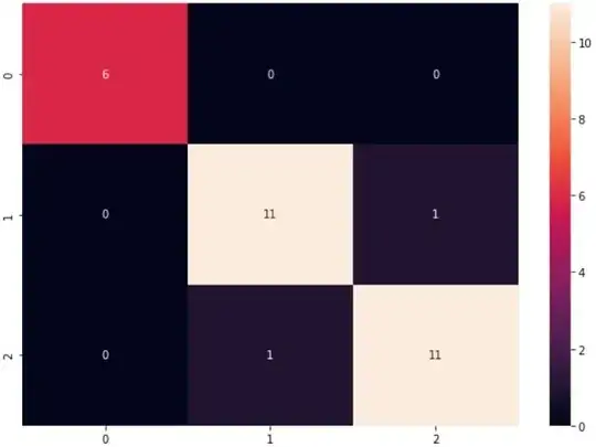

import seaborn as sn
%matplotlib inline
plt.figure(figsize=(10,7))
sn.heatmap(cm,annot=True)
You can increase Heatmap size by using plt.figure(figsize=(10,7))
The basic idea is to increase the default figure size in your plotting tool. You need to import matplotlib and set either default figure size or just the current figure size to a bigger one. Also, seaborn is built on top of matplotlib. You need to install and import matplitlib to make the best use of seaborn library.
