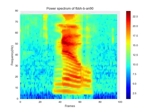

I am currently working with speech recognition, in which i would like to try to use CNN instead of the normal feature extraction step.
I been reading this paper which proposes method using cnn. The input is a visual representation of mel-log filter bank energies of audio files.
And the output is phoneme recognised for each third frame section a portion (a frames, b frequency_bands) of the image.
The network is a CNN, and they propose a different weight sharing - limited weight sharing, since the patterns being seeked for doesn't occur equally anywhere on the image, but localised to certain frequency areas.

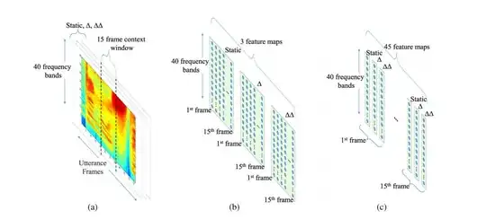

They made a illustration of this weight sharing:
From what i can decipher from the image - is Limited weight sharing option 2.
Each frame do not have the same weight, multiple convolution is applied on to the same frame, and the convolution for the next frame starts at a lower frequency than than the previous frame and has stride = 2. So somehow is the convolution only performed in the diagonal of the image... sounds weird?
Sounds like i've misinterpreted something incorrectly here? Any ideas on how to implement?

It's important to note that before doing this, they split the frames into individual feature maps. Note Fig. 1:
enter image description here The "45 rows" in the upper left of your diagram (Fig 4.) corresponds to 15 frames times 3 feature maps.
The convolution is a 1D convolution, so they are not actually convolving across multiple frames, only across frequencies. The authors then sum across feature maps in the normal way, meaning summing across frames and features.
Another way of looking at it is in Eq. 9
The variable $O_i$ is a vector across frequency bands only. The sum is over feature maps which includes frames.
