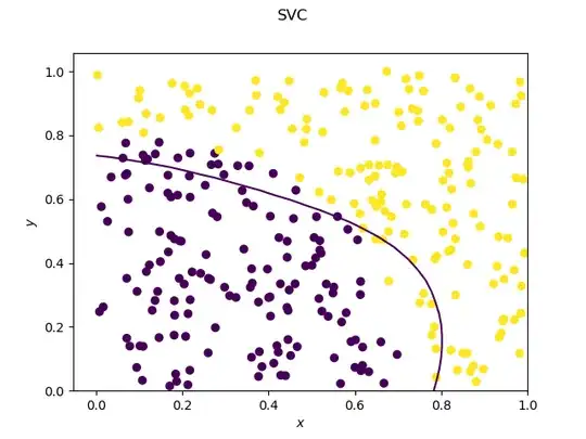

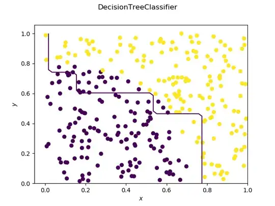

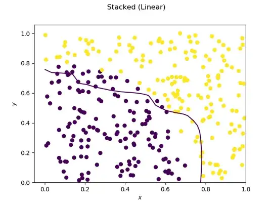

  • More general decision boundaries. The graphs below show the decision boundaries of two models, and the stacked version of these two models:
As you can see, the last graph seem to appear to a more general class of functions than the first two graphs, allowing to learn more general boundaries
