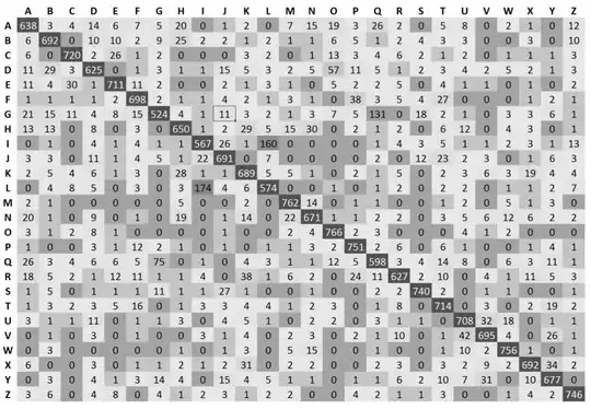

Here is an example for a big confusion matrix.
Examples in the Wild
Figure 6 of EMNIST looks nice:
It is easy to see where many cases are. However, those are only $26$ classes. If the whole page was used instead of only one column this could probably be 3x as many, but that would still only be $3 \cdot 26 = 78$ classes. Not even close to 369 classes of HASY or 1000 of ImageNet.

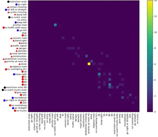

You can apply a technique I described in my masters thesis (page 48ff) and called Confusion Matrix Ordering (CMO):
  1. Order the columns/rows in such a way, that most errors are along the diagonal.
  2. Split the confusion matrix into multiple blocks such that the single blocks can easily printed / viewed - and such that you can remove some of the blocks because there are to few data points.
Nice side effect: This method also automatically clusters similar classes together. Figure 5.12 of my masters thesis shows that:
You can apply confusion matrix ordering with clana

Its important to know why the EMNIST confusion matrix looks good.
But I find it weird that they haven't maintained the colouring with higher numbers being darkest, for example most of the empty miss-classifications containing zeros are of a darker grey than those that contain an integer. Doesn't seem consistent.
I'd try using the EMINST style except keep it consistent where colour indicates the number of entries in a cell. White for zero entires, and black for the most entries.
A perfect classification would be a black diagonal with completely white upper and lower triangles. Where there was any grey patches in the triangles would indicate problems. Even on a 1000 class set this would be helpful. For ImageNet where the classes are hierarchical, perhaps sorting the columns so that subclasses are grouped the right of the parent class would lead to squareish dark patches.
Also if you are getting the top 5 responses for an image, classes may not be mutually exclusive, such that dog classification for an image of a lap_dog should still be true, hence in such a confusion matrix, the more general classes should be much darker than the precise classifications (if the colours are normalised.) Hence the top left square would be darkest.
