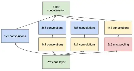

The paper Going deeper with convolutions describes GoogleNet which contains the original inception modules:

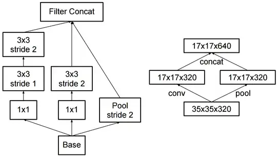

The change to inception v2 was that they replaced the 5x5 convolutions by two successive 3x3 convolutions and applied pooling:
