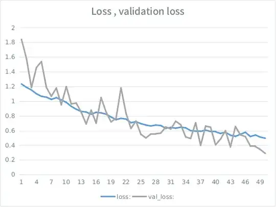

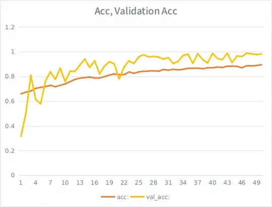

I have a convolutional + LSTM model in Keras, similar to this (ref 1), that I am using for a Kaggle contest. Architecture is shown below. I have trained it on my labeled set of 11000 samples (two classes, initial prevalence is ~9:1, so I upsampled the 1's to about a 1/1 ratio) for 50 epochs with 20% validation split.I was getting blatant overfitting for a while but I thought it got it under control with noise and dropout layers.
Model looked like it was training wonderfully, at the end scored 91% on the entirety of the training set, but upon testing on the test data set, absolute garbage.
Loss by epoch
Validation accuracy by epoch
Notice: the validation accuracy is higher than the training accuracy. This is the opposite of "typical" overfitting.
My intuition is, given the small-ish validation split, the model is still managing to fit too strongly to the input set and losing generalization. The other clue is that val_acc is greater than acc, that seems fishy. Is that the most likely scenario here?
If this is overfitting, would increasing the validation split mitigate this at all, or am I going to run into the same issue, since on average, each sample will see half the total epochs still?

I am not sure if the validation set is balanced or not. You have a severe data imbalance problem. If you sample equally and randomly from each class to train your network, and then a percentage of what you sampled is used to validate your network , this means that you train and validate using balanced data set. In the testing you used imbalanced database. This means that your validation and testing sets are not equivalent. In such case you may have high validation accuracy and low testing accuracy. Please find this reference that talks mainly about data imbalance problem for DNN, you can check how they sample to do the training, validation and testing

If your training loss goes under you validation loss, you are overfitting, even if validation is still dropping.
It is the sign that your network is learning patterns in the train set that are not applicable in the validation one
