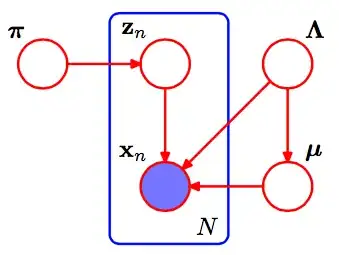

This is the pgm of Gaussian Mixture.

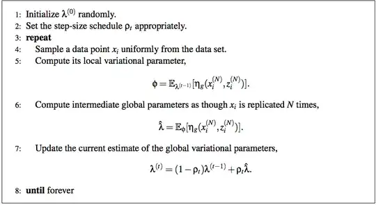

According to the paper, the full algorithm of stochastic variational inference is: enter image description here
And I am still very confused of the method to scale it to GMM.
First, I thought the local variational parameter is just $q_z$ and others are all global parameters. Please correct me if I was wrong. What does the step 6 mean by as though Xi is replicated by N times? What am I supposed to do to achieve this?
Could you please help me with this? Thanks in advance!
