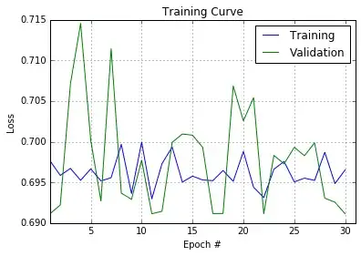

I have trained a simple CNN (using Python + Lasagne) for a 2-class EEG classification problem, however, the network doesn't seem to learn. loss does not drop over epochs and classification accuracy doesn't drop from random guessing (50%):
training curve
Questions
  1. Is there anything wrong with the code that is causing this?
  2. Is there a better (more correct?) way to handle EEG data?
EEG setup
Data is collected from participants completing a total of 1044 EEG trials. Each trial lasts 2 seconds (512 time samples), has 64 channels of EEG data, and labelled 0/1. All trials have been shuffled so as to not learn on one set of participants and test on another.
The goal is to predict the label of a trial after being given the 64x512 matrix of raw EEG data
The raw input data (which I can't show here as its part of a research project) has a shape of (1044, 1, 64, 512)
train/validation/test splits are then created at 60/20/20%
With such a small dataset I would have thought overfitting would be a problem, but training loss doesn't seem to reflect that

There are a lot of possible reasons why your setup might not work. However, one very good start is to try to overfit your model on a very small subsample of your entire dataset just to see if the problem is in the code.
jtitusj
  • 121
I had the same problem when I used TensorFlow to build a self driving car. The training error for my neural nets bounced around forever and never converged on a minimum. As a sanity check I couldn't even intentionally get my models to overfit, so I knew something was definitely wrong. What worked for me was scaling my inputs. My inputs were pixel color channels between 0 and 255, so I divided all values by 255. From that point onward, my model training (and validation) error hit a minimum as expected and stopped bouncing around. I was surprised how big of a difference it made. I can't guarantee it will work for your case, but it's definitely worth trying, since it's easy to implement.
Ryan Zotti
  • 4,209
  • 21
  • 33
1.Your input layer seems off, the first dimension is for channels, please try, with the data formatted correctly :
l_in = InputLayer(shape=(None, 64, 512, 1 ), input_var=input_var)
A more clean way would be to replace the conv2dlayer by a conv1dLayer, which is what you are replicating.
2.There is no correct way to handle eeg. But people often also use spectrograms and feature extraction
