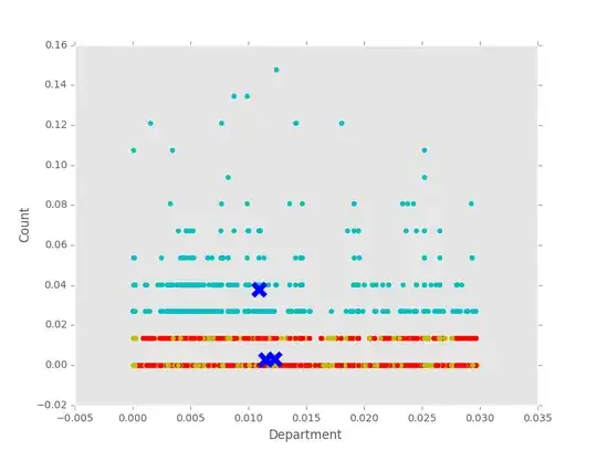

I started tinkering with sklearn kmeans last night out of curiosity with the goal of clustering users into groups to see what kind of user groups I can derive. I am lost when it comes to plotting the results as most examples have nice (x,y) coordinates. For example, the iris data set has pedal width and pedal length. From my experimentation, I don't seem to have anything that displays very nice. Is this assumption correct / does anyone have tips, pointers, learning resources that they could offer?

I normalized the data as it had a wide variance...again, not sure if this is a correct assumption to make
X = np.array(normalize(data, axis=0, copy=False))
kmeans = KMeans(n_clusters=3)
pred = kmeans.fit_predict(X)
labels = kmeans.labels_
cent = kmeans.cluster_centers_
plt.scatter(X[:, [4]], X[:, [6]])
plt.scatter(cent[:, [4]], cent[:, [6]], marker="x", s=150, linewidths=5, zorder=10)
plt.ylabel('Count')
plt.xlabel('Department')
plt.show()

Example clustering using entire data set:
anshanno
This has been answered in other places e.g. here.
