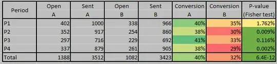

As you can imagine, this did not happen at all. We sent roughly 3500 mails to each branch, and one of these exhibits a 40% conversion while the other only has 32%, which is a difference that has a p-value of the order of 10^-12
Furthermore, we partitionned the time in 4 periods, each one of these exhibit a very significant difference with the other one.
Results of AA testing

  • Make sure this is not a statistical artifact : test your hypothesis on several independant periods. I used a Fischer test because it is exact for a binomial framework, it is what you should use if your population/conversion rate is too small for a normal approximation

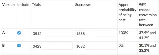

Using frequentist hypothesis testing in this manner (using the p-value to determine pass/fail) has serious drawbacks even in bug-free software. My suggestion is to use some form of Bayesian A-B testing. There is much nerd debate about this (frequentist vs. Bayesian A/B testing).
First, some references. Then we'll have a look at your AA test with the online calculator.
On using p-values as pass/fail criteria:
On Bayesian A/B testing:
In your case the frequentist and Bayesian approaches agree-- your "A" is not equal to your other "A". It appears that there are one or more currently unseen variable(s) you need to take into account. If it was a question of insufficient data, the two peaks would not be so nicely separated. I'd be interested in hearing other possible explanations.
