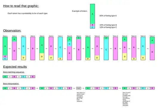

Let's complexify it a bit. From now each token has no determined type. In the real world, we are not always 100% sure of some token's type. Instead, we give it a probability of having a certain type.
  A 0.2    A 0.0    A 0.1
  B 0.5    B 0.5    B 0.9     etc.
  C 0.0    C 0.0    C 0.0
  D 0.3    D 0.5    D 0.0
Here is an abstract graphic of what I want to achieve:

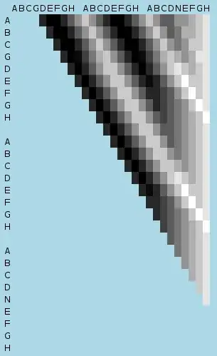

e.g. Let's have the input sequence ABCGDEFGH ABCDEFGH ABCDNEFGH.
We compute the distance of every suffix with every suffix (cropped to be of equal size):
for i = 0 to sequence.lengh
  for j = i to sequence.lengh
    # Create the suffixes
    suffixA = sequence.substr(i)
    suffixB = sequence.substr(j)
    # Make the suffixes the same size
    chunkLen = Math.min(suffixA.length, suffixB.length)
    suffixA = suffixA.substr(0, chunkLen)
    suffixB = suffixB.substr(0, chunkLen)
    # Compute the distance
    distance[i][j] = LevenshteinDistance(suffixA, suffixB)
We get e.g. the following result (white is small distance, black is big):

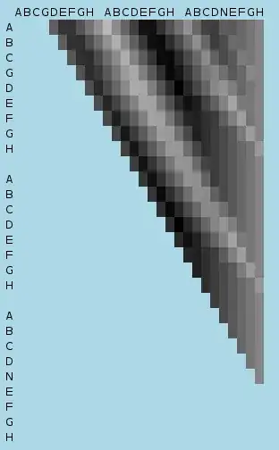

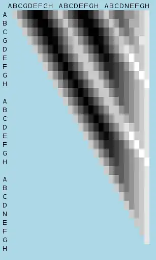

Now, it's obvious that any suffix compared to itself will have a null distance. But we are not interested by suffix (exactly or partially) matching itself, so we crop that part.
Since the suffixes are cropped to the same size, comparing long string will always yield a bigger distance than comparing smaller strings.
We need to compensate that by a smooth penalty starting from the right (+P), fading out linearly to the left.
I am not sure yet how to choose a good penalty function that would fit all cases.
Here we apply a (+P=6) penalty on the extreme right, fading out to 0 to the left.

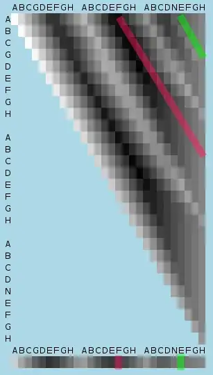

Now we can clearly see 2 clear diagonal lines emerge. There are 3 Items (Item1, Item2, Item3) in that sequence. The longest line represents the matching between Item1 vs Item2 and Item2 vs Item3. The second longest represents the matching between Item1 vs Item3.
Now I am not sure on the best way to exploit that data. Is it as simple as taking the highest diagonal lines?
Let's assume it is.
Let's compute the average value of the diagonal line that start from each token. We can see the result on the following picture (the vector below the matrix) :
There are clearly 3 local minima, that match the beginning of each Item. Looks fantastic!

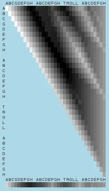

Now let's add some more imperfections in the sequence: ABCGDEFGH ABCDEFGH TROLL ABCDEFGH
Clearly now, our vector of diagonal averages is messed up, and we cannot exploit it anymore...
My assumption is that this could be solved by a customized distance function (instead of Levenshtein), where the insertion of a whole block may not be so much penalized. That is what I am not sure of.
