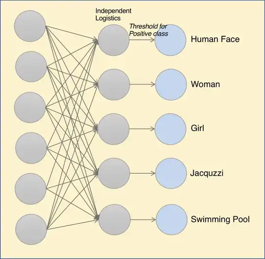

In simple words, the NCE is just a multi-label classification loss function with only 1 positive label and k sampled negative ones.
Illustration of multilabel classification: enter image description here
Source: Approaches to Multi-label Classification
