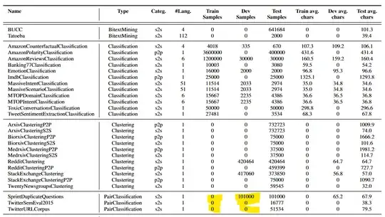

I'm trying to locally replicate the pair classification task of MMTEB/MTEB. However, I didn't find train/dev sets for all datasets in this task.
Table 2 in the original MTEB paper (Mueninghoff et al, 2023) shows that there is no train data for the 3 pair classification datasets and only SprintDuplicateQuestions has a Dev data: enter image description here

So I am wondering what data is used to determine that threshold?

MTEB does not train any model to determine the threshold. Instead, it uses the average precision as the main metric which does not require any threshold since it
summarizes a precision-recall curve as the weighted mean of precisions achieved at each threshold [...].
However, Muenninghof et al (2023) do indeed report the other metrics (accuracy, f1, precision and recall) based on the best binary threshold. These thresholds are determined by iteratively searching the test data as can be seen in their Github repository.

The quote from the paper you provided is, hence, inaccurate. The average precision is not found by searching for the best binary threshold. Rather it summarizes the Precision-Recall-Curve, i.e. all possible thresholds.
The other metrics (accuracy, f1, precision and recall) need to be taken with some caution since they are found by searching the test data and are not determined based on train data.
