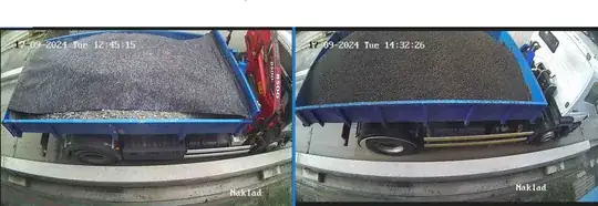

The purpose of my model is to determine, whether the picture is a truck with covered load or anything else. So at minimum I need ony 2 categories of images. Similar to a person wearing respirator or not, etc.
Some of the pictures are rather similar.... Covered on the left, uncovered on the right. CoveredVsUncovered
