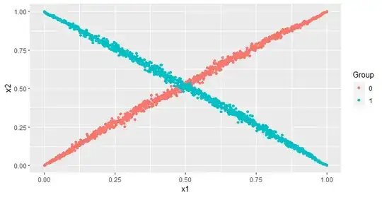

If you use a more sophisticated machine learning model like a random forest or a neural network, even a logistic regression with feature interactions, then univariate screening is even more problematic. Consider the image below (taken from another post of mine).
red/blue X
Jointly, the two features almost perfectly distinguish between red and blue. However, neither feature, alone, is at all correlated with the color. If you have interaction terms in a logistic regression or run a model like a random forest or neural network that will interact features as it sees fit, then you miss out on these being important features, even if their importance only happens in the interaction.
You can explicitly test for a correlation between the interaction and the outcome, which would reveal the interaction in this case to be extremely important, but then you're doing univariate screening (the interaction feature is, after all, a candidate feature), which is problematic as described above.
