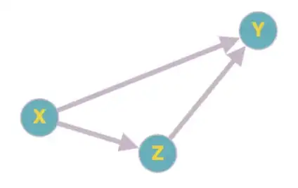

On the other hand, the goal of Causal Inference (CI) requires you to identify a causal graph from your data, which can then be used in your model to A) make predictions and B) query the model for insights that traditional ML methods cannot give, such as interventions.
This causal graph that you need to build explains the cause and effects between the features and the target, and between the features themselves. For example, let’s say we have 2 features X and Z and a target Y. This shows that X directly affects the target, but also indirectly affects the target via the feature Z. It’s this type of information that CI takes into account that SA doesn’t.
example of a graph with 3 nodes: X, Y and Z and 3 relationships X->Y, Z->Y, X->Z
