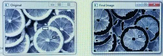

In the picture below there are some regions which are very bright (i.e. more white). Some bright regions are wide and some are narrow or thin. The red box covers one such wide bright spot, and blue box covers one thin bright spot. Thin bright spots are called edges and wide bright spots are called hot-spots.
I want to remove all the hot-spots from the image (i.e. make them black), but no edge should be removed.
My question is how to write Python code using OpenCV to remove all hot-spots but no edge?

Based on this answer's algorithm I have written my code which is working as intended.
Here's a breakdown of the coding steps:
  1. Otsu's thresholding is applied to the grayscale image1 using cv2.threshold() with the cv2.THRESH_BINARY + cv2.THRESH_OTSU flag to obtain image2.
  2. Erosion is performed on image2 using cv2.erode() with a square kernel to obtain image3.
  3. The threshold distance K is defined.
  4. You then compare to 0 for pixels where image2 is larger than 0. So you can combine the result of the two full-image comparisons with the logical and(&) operator, and use the result to index into the output image.
  5. The final image is displayed using cv2.imshow().
Note that a square region with side 2*K is used instead of a circular mask in this implementation. The choice between a circular or square area can be adjusted by modifying the mask variable in the code. Feel free to adjust the threshold distance K and experiment with different shapes and sizes of the neighborhood mask to suit your specific requirements.

Output:
