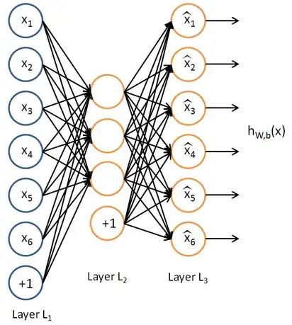

The full answer to your question is yes and no. Let me elaborate:
Yes, you can train such a model with SGD:
Yes, you can train a model like you described. This is well known under the name "Autoencoder". The goal of an autoencoder is to find a (usually smaller) representation of the input data, which can then be used to reconstruct the data. This looks as follows:
Structure of an autoencoderImage taken from standford.edu
We try to make $\hat{x}_1$ equal to $x_1$. In your code, you add the additional constraint that $W_1$ (the weights from the input layer to the hidden layer) are equal to $W_2$ (the weights from the hidden layer to the output layer). The reconstruction error is usually either the squared error or the cross-entropy. Such an autoencoder can be trained with SGD, as you proposed.
So, the answer is: yes, what you propose does work and is known as Autoencoder.
