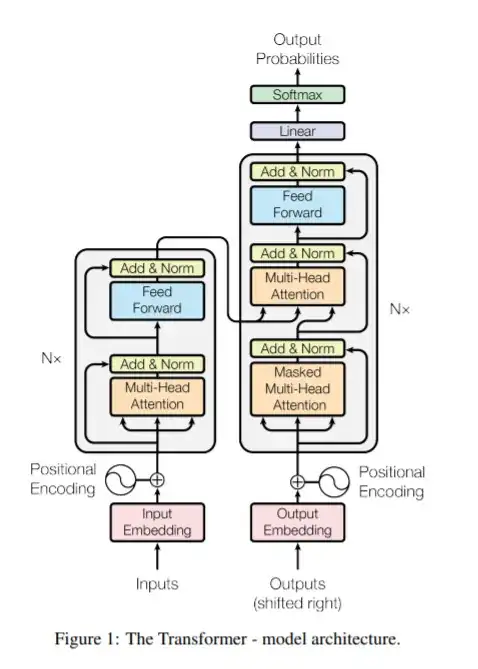

TLDR (simplified):
  1. encoder sees into future, decoder predicts
  2. transformer sees into future and then predicts, encodes, then decodes
  3. gpt doesnt see into future, it only predicts - thats why it's decoder-only
you can check karpathy's explanation: https://youtu.be/kCc8FmEb1nY?t=6159 (~2m short, at the linked time, or for full understanding watch the whole 2h video, or even whole ~10h series)
basically, gpt decoder doesnt look into future, it is only predicting, so this is the decoding part.. and it is specific in that we dont know the full context of sentence..
however, in case of translating from one language to another, we know the full context from the original sentence, so basically before running the decoder to predict the next part, we first encode the context from the original language
to simplify, you could say, in this usecase, that encoding is more about encoding what the data means into symbolic representation, while decoding is more about predicting the output - the original transformer did both of these things, while gpt only does the second part
(to be clear, there is always some "encoding" in any code, but we are talking about transformer-style encoding when deciding whether to call gpt an encoder, and such encoding is not being done. but there are word/token embeddings being done in decoder, which you could call encoding, but that is just simple data processing. but in case of transformer, there is huge neural network that does encoding)

Amazing how much dissonance exists on this very basic question-- are GPT2 based LLM's (GPT3 and ChatGPT) encoder-decoder or decoder only models? Googled ranked answers are all over the map with most converging on the responses here that they are "decoder only" models.
Well...... you can't decode data without first starting with encoded data. So the answer is.... OpenAI's GPT2 and subsequent models are encoder-decoder, but are commonly referred to as decoder models because the decoder part (right side of diagram) makes them distinct from the seq2seq -> BERT model evolutionary path from which they descended. But that does not mean they are "decoder only" or lack an encoder. It means that in contrast to BERT models which are "encoder only," they also invoke decoding.
  • All the above hypothesis only.

I appreciate the debate going on in the other answers. I think we need to get into semantics.
There are three generally-accepted classes of transformer LLM architectures: encoder, decoder, and encoder-decoder. Within this overly-simplistic taxonomy, the OpenAI GPT family of LLMs seem to best fit in the decoder branch because they do not have a full encoder like BERT, so they can't do things like extract structured data, e.g. named entity recognition, directly.
On the other hand, no language model can understand language without some form of encoding. At a minimum, the LM needs to convert words into word embeddings. This could be considered a form of encoding, though a very minimal one. I suspect ChatGPT does much more than word embeddings, so it would have an even less-than-minimal encoder.
But I'm not an expert, so I can't give details here ... yet.

The T5 paper (section 3.2.1) has a very readable discussion of various Transformer model structures. It says
As such, a Transformer decoder (without an encoder) can be used as a language model (LM), i.e. a model trained solely for next-step prediction (Liu et al., 2018; Radford et al., 2018; Al-Rfou et al., 2019).
where Radford et al., 2018 is the GPT paper.
As the T5 paper explains, "decoder" refers to a stack of Transformer layers with masked attention that cannot look ahead to future tokens, like the decoder in the original Transformer paper. It does not imply the presence of a side input from an encoder, because there is no encoder.
According to noe's answer, this answer for GPT should carry over to the original question on ChatGPT.
