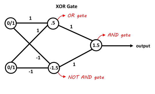

12
A network with one hidden layer containing two neurons should be enough to separate the XOR problem. The first neuron acts as an OR gate and the second one as a NOT AND gate. Add both the neurons and if they pass the threshold it's positive. You can just use linear decision neurons for this with adjusting the biases for the thresholds. The inputs of the NOT AND gate should be negative for the 0/1 inputs. This picture should make it more clear, the values on the connections are the weights, the values in the neurons are the negatives of the biases. E.g. for input1=0 / input2=1, hidden neuron 1 would be sign function(0*1 + 1*1 - 0.5) == 1, meaning it passes the OR gate. The decision functions act as 0/1 decisions (or just the sign function works in this case too).
XOR Neural Network
Picture thanks to "Abhranil blog"

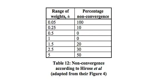

9
Yes, there is a reason. It has to do with how you initialize your weights.
There are 16 local minimums that have the highest probability of converging between 0.5 - 1.
Here is a paper that analyses the xor problem: Learning XOR: exploring the space of a classic problem, Bland 1998.
Ben Reiniger
