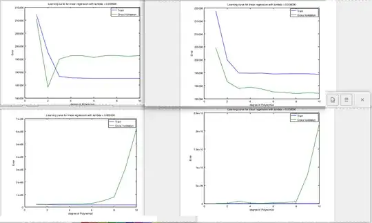

I'm trying to predict the birth weight baby using polynomial regression model. First what I need know what degree polynomial should fit better to my data. In order to do that I split my dataset in training set (70%) and Cross Validation set(30%) and then plots each error by degree polynomial. I did run my script 4 times selecting randomly the data but I get so different curves each time as you can see
I don't know why this happens or What am I doing wrong.

Can anyone help me?
Overflow012
  • 119
You appear to be implementing many parts of the process. If you switched to established packages, you can get trustworthy results. Then compare the trustworthy results to yours to see if you have an implementation bug.
