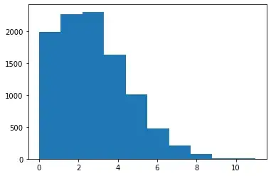

I generated a Poisson distribution with mean equal to 3 and 10000 samples by using np.random.poisson(3,10000). The plot is the following:
from this plot I see that given the mean equal to 3, a point like 12 is very unlikely to fall into the distribution. Is there a function that given the number 12 and a probability to fall in the distribution, gives me the mean of such distribution ?
