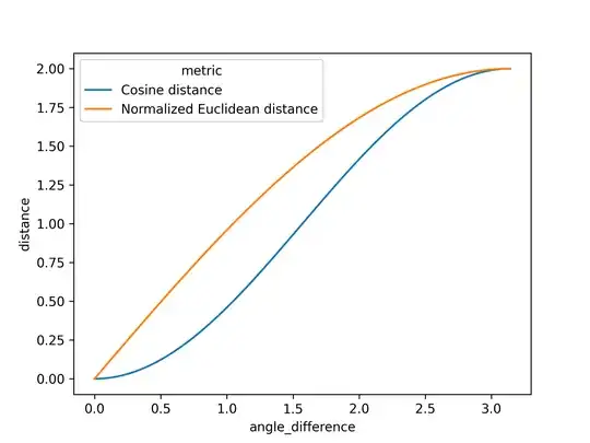

Let $u, v$ be vectors. The "cosine distance" between them is given by
$$d_{\cos}(u, v) = 1 - \frac{u}{\|u\|} \cdot \frac{v}{\|v\|} = 1 - \cos \theta_{u,v},$$
and the proposed "normalized Euclidean distance" is given by
$$d_{NE}(u, v) = \left\| \frac{u}{\|u\|} - \frac{v}{\|v\|} \right\| = d_E(\frac{u}{\|u\|}, \frac{v}{\|v\|}).$$
By various symmetries, both distance measures may be written as a univariate function of the angle $\theta_{u,v}$ between $u$ and $v$. [1] Let's then compare the distances as a function of radian angle deviation $\theta_{u,v}$.
Evidently, they both have the same fundamental properties that we desire -- strictly increasing monotonicity for $\theta_{u,v} \in [0, \pi]$ and appropriate symmetry and periodicity across $\theta_{u,v}$.
Their shapes are different, however. Euclidean distance disproportionately punishes small deviations in the angles larger than is arguably necessary. Why is this important? Consider that the training algorithm is attempting to reduce the total error across the dataset. With Euclidean distance, law-abiding vectors are unfairly punished ($\frac{1}{2} d_{NE}(\theta_{u,v} = \pi/12) = 0.125$), making it easier for the training algorithm to get away with much more serious crimes ($\frac{1}{2} d_{NE}(\theta_{u,v} = \pi) = 1.000$). That is, under Euclidean distance, 8 law-abiding vectors are just as bad as maximally opposite-facing vectors.
Under cosine distance, justice is meted out with more proportionate fairness so that society (the sum of error across the dataset) as a whole can get better.
[1] In fact, $d_{\cos}(u, v) = \frac{1}{2} (d_{NE}(u, v))^2$.
