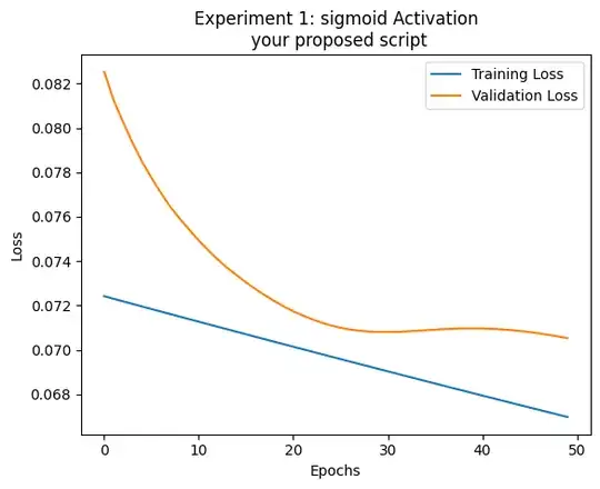

The answer to this question is that you need to modify the final layer to use 'sigmoid' and evaluate the reconstruction loss compared with others with different AFs. In general, 'softmax' is good for classification tasks over categorical distributions, but if you rescale your data between [0, 1], 'sigmoid' is better. (I added it to your code)
img img
Fig. 1: AF='softmax' Fig. 2: AF='sigmoid'

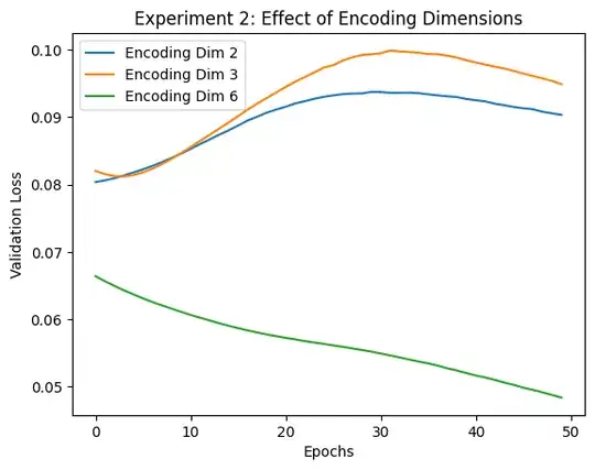

  • Altering the smallest change in the layers (encoding layer going to 6 instead of 3) --> causes a major shift in the loss -- is this normal?
The following plot demonstrates the trade-off between compression (lower dimensions) and reconstruction loss. So one needs to experiment with it, so don't trust much Gen-AI tools answer as below I have shown in blockquote:
"Impact of Layer Dimensions on Loss: A significant change in loss when altering the dimensions of the encoding layer is expected. A smaller encoding layer forces the autoencoder to compress the information more, which might increase reconstruction error if the model cannot learn an efficient representation." [this paragraph generated by ChatGPT 4o, Accessed: 19.12.2024, prompt: Q3]
# Experiment 2: Varying Encoding Dimensions
encoding_dims = [2, 3, 6]
results = {}
for dim in encoding_dims: # Encoder encoded = Dense(dim)(input_layer) encoded = BatchNormalization()(encoded) encoded = LeakyReLU()(encoded)
