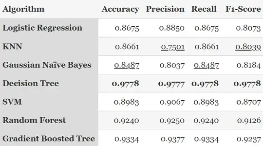

You Can a get brief idea about the accuracy of models for Flight Delay Algorithm. enter image description here
