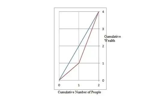

I took an example of Data with two people A and B with wealth of unit 1 and unit 3 respectively. Gini Impurity as per Wikipedia = 1 - [ (1/4)^2 + (3/4)^2 ] = 3/8
Gini coefficient as per Wikipedia would be ratio of area between red and blue line to the total area under blue line in the following graph
Area under red line is 1/2 + 1 + 3/2 = 3
Total area under blue line = 4
So Gini coefficient = 3/4
Clearly the two numbers are different. I will check more cases to see if they are proportional or there is an exact relationship and edit the answer.

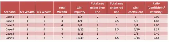

Edit: I checked for other combinations as well, the ratio is not constant. Below is a list of few combinations I tried. enter image description here
