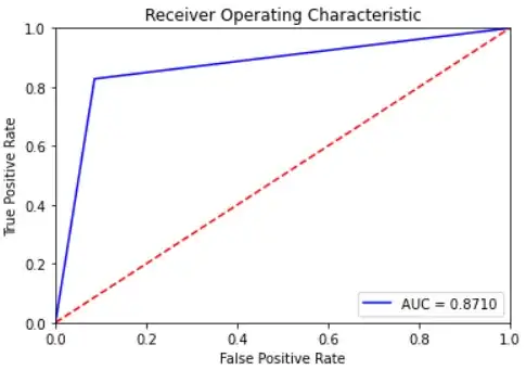

I am working on a binary classification and the plotted ROC curves that I am using for evaluation together with AUC, have seemed strange to me. Here is an example.

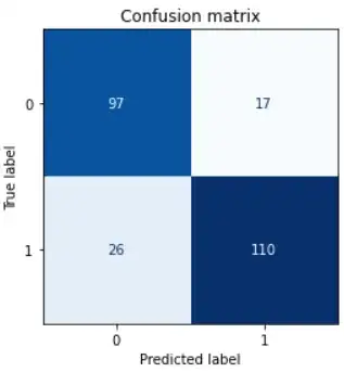

I understand that ROC is a visual representation of the true positive rate versus the false positive rate. When plotting the confusion matrix I can see there are significant number of false negatives and false positives alike:
I fail to understand how it is possible that the ROC curve only has a single break point. My question therefore is: What is the reason for ROC having such a shape instead of the typical smooth(er) monotonically increasing shape?
I tried playing around with the n_iter argument of RandomizedSearchCV, with the n_splits of StratifiedKFold and with the classifier estimator used (LogisticRegression(), RandomForestClassifier()).

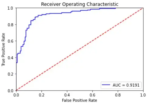

And this will now yield a nice ROC curve as expected:
