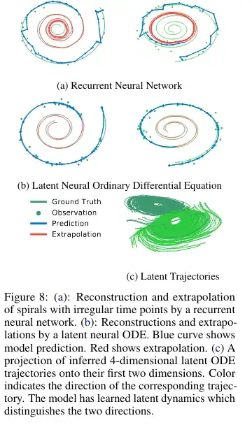

A different approach would be to use neural ode's (arxiv:1806.07366) and neural stochastic ode's (arxiv:2001.01328). They don't need timestamps (as features) and work well with irregularly sampled data points as you don't have to work with discrete steps.
(image below is from Neural Ordinary Differential Equations arxiv:1806.07366)
Image from arxiv:1806.07366
About the timestamps I believe sin cos positional encodings will work fine, but if the timestamps repeat when the data has it's natural cycle it might work even better. (as it constrains the model more than just positional encodings in a way that fits well with your data)
