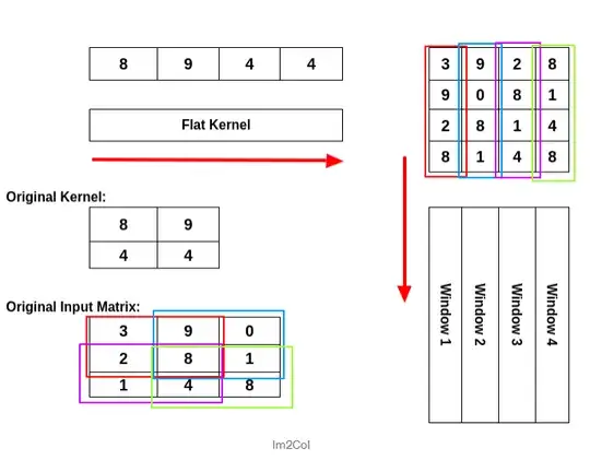

The second one: Instead of the filter, modify the input in a way that it will store the values used by specific kernel operations in column vectors. Then the kernel -layed out in a row vector- should be multiplied by the matrix that holds the modified input like so

In the second solution, the modified input would have about 10^6 elements (958 * 718 * kernel-size).
I think it is clear that the second option is so much quicker to compute, am I missing something, did I miss calculate something? The literature keeps referring to Toeplitz matrices when it comes to this problem but I just can not see the second solution to have anything in common with them. Does the matrix in the second one have a specific name?
Is the second one the way to go if I want to implement image convolution? Is there a more efficient solution or a mathematical trick perhaps?
