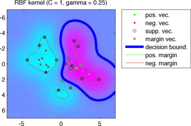

For nonlinear data, when we are using Support Vector Machines, we can use kernels such as Gaussian RBF, Polynomial, etc to achieve linearity in a different (potentially unknown to us) feature space and the algorithm learns a maximal separating hyperplane in that feature space.
My question is how do we create heatmaps such as the one seen in the image below to show this max. separating hyperplane in our original space and how should it be interpreted?

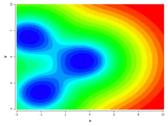

Mesh curves for grained colour step

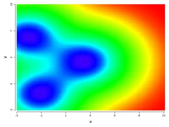

Mesh curves for fine colour steps

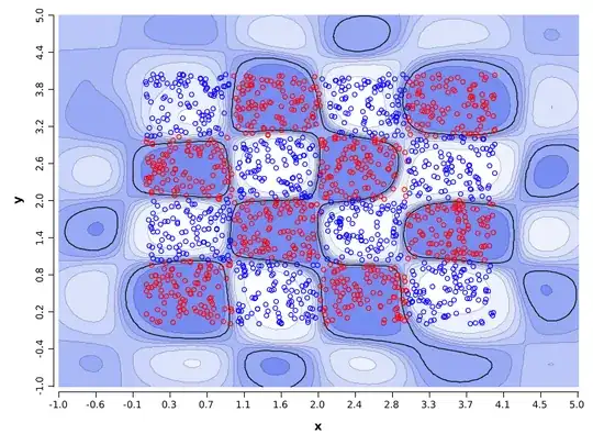

SVM on synthetic data
