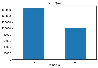

To identify the type of missing data I tried the following method. I plotted the following plot:
Here the feature BsmtQual has nan values so I plotted the nan values against the dependent feature SalePrice. 0 means it is not a nan value and 1 means it is a nan value. Clearly there is some relationship between the nan values and the target variable as houses with missing values are sold for less price than house with non missing values. So this missingness is MNAR and I would use a MNAR technique to deal with nan values for this feature.
Is this process right? If not is there anyway I can identify what kind of missing data I have (aside from Little's Test)?
