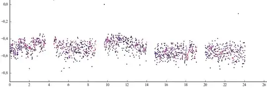

A good measurement looks like that (image at the end of the post):
The x-axis represent the time-axis calulated to a length in mm. The y-axis is the depth-axis and the color represent the intensity of that datapoint.

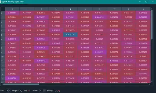

  4. Then a fited my data into my model but if i do so, i get a prediction of every datapoint (look image at the end of this post) in a shape of (x, 1700, 1), not on a file itself (shape of (x, 1)).
     model.fit(X_train, y_train)
     y_pred = model.predict(X_test)

Good data: good data

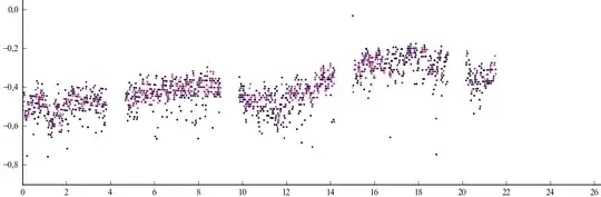

Bad data: bad data
y_pred - Output: y_pred
Shapes of my X_train, X_test, y_train, y_test: shapes
