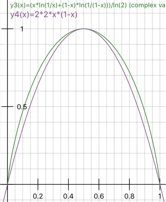

For the case of a variable with two values, appearing with fractions $f$ and $(1-f)$,
the gini and entropy are given by:
$gini = 2*f(1-f)$
$entropy = f*ln\big({1\over f}\big) + (1-f)*ln\big({1\over(1-f)}\big)$
These measures are very similar if scaled to $1.0$ (plotting $2*gini$ and ${entropy\over ln(2)}$):
Gini (y4,purple) and Entropy (y3,green) values scaled for comparison

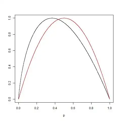

To add upon the fact that there are more or less the same, consider also the fact that: $$ \begin{split} \forall \; 0 < u < 1,\; \log (1-u) &= -u - u^2/2 - u^3/3 \, + \, \cdots\\ \forall \; 0 < p < 1,\; \log (p) &= p-1 - (1-p)^2/2 - (1-p)^3/3 \, + \, \cdots\\ \end{split} $$ so that: $$ \forall \; 0 < p < 1,\; -p \log (p) = p(1-p) + p(1-p)^2/2 + p(1-p)^3/3 \, + \, \cdots $$ See the following plot of the two functions normalised to get 1 as maximum value: red curve is for Gini while black one is for entropy. Normalised Gini and Entropy criteria
In the end as explained by @NIMISHAN Gini is more suitable to minimise misclassfication as it is symetric to 0.5, while entropy will more penalised small probabilities.

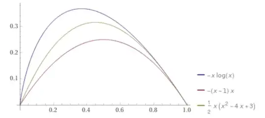

Gini Impurity $G$ is a first order approximation to Information Gain $IG$.
To see that first note that the sum of all probabilities $p_i$ over $N$ classes is $\sum_{i=1}^N p_i=1$. So we can rewrite Gini Impurity like $$ G = 1 - \sum_{i=1}^N p_i^2 = \sum_{i=1}^N p_i - \sum_{i=1}^N p_i^2 = \sum_{i=1}^N p_i(1-p_i) $$ To rewrite Information Gain note that the natural logarithm can be expressed as an infinite series (see https://en.wikipedia.org/wiki/Mercator_series) like $$ \ln(1-x) = -x - \frac{1}{2}x^2 - \frac{1}{3}x^3 - \ldots $$ The Information Gain can then be expressed like $$ \begin{align} IG &= - \sum_{i=1}^N p_i \ln(p_i) = - \sum_{i=1}^N p_i \ln(1 - (1-p_i)) \\ &= - \sum_{i=1}^N p_i \left[-(1-p_i) - \frac{1}{2}(1-p)^2 - \frac{1}{3}(1-p)^3 + \ldots \right] \\ &= \sum_{i=1}^N \color{red}{p_i } \left[\color{red}{(1-p_i)} + \frac{1}{2}(1-p)^2 + \frac{1}{3}(1-p)^3 + \ldots \right] \end{align} $$ The first term (in red) in this infinite series to compute the Information Gain is exactly the Gini Impurity $G$.
So which metric to use? If you need maximum speed use the Gini Impurity. If you need the theoretical exact solution use Information Gain. And as a compromise you can for example use the second order approximation to Information Gain: $$ IG \approx \sum_{i=1}^N p_i (1-p_i) + p_i\frac{1}{2}(1-p)^2 = \frac{1}{2}\sum_{i=1}^N p_i(1-p_i)(3-p_i) $$ The plot below (screenshot from Wolfram Alpha with $x=p_i$) shows Gini Impurity in red, Information Gain in blue and the second order approximation in green. The second order approximation to Information Gain sits basically in the middle between the Gini Impurity and Information Gain.
