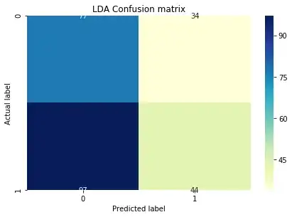

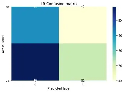

Logistic Regression and LDA was pretty straight forward in terms of implementation. Here are the confusion matrices on a test dataset.

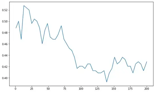

Both of them are pretty similar with almost same accuracy. But I tried finding a K for KNN by plotting the loss vs K graph:

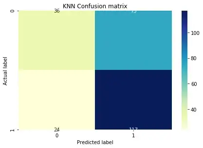

and chose a K around 125 to get this confusion matrix (same test dataset)
Although the KNN gave a higher accuracy of around 0.61, the confusion matrix is very different from logistic and LDA matrices with a much higher true negative and a low true positive. I cant really understand why this is happening. Any help would be appreciated.

  • If I'm not mistaken the majority class (class 1) has 141 instances out of 252, i.e. 56% (btw the numbers are not easily readable in the matrices). This means that a classifier which automatically assigns class 1 would reach 56% accuracy. This is called the majority baseline, this is usually the minimal performance one wants to reach with a binary classifier. The LR and LDA classifiers are worse than this, so practically they don't really work.
  • The k-NN classifier appears to give better results indeed, and importantly above 56% so it actually "learns" something useful.
  • It's a bit strange that the first 2 classifers predict class 0 more often than class 1. It looks as if the training set and test set don't have the same distribution.
  • the k-NN classifier correcly predicts class 1 more often, and that's why it works better. k-NN is also much less sensitive to the data distribution: in case it differs between training and test set, this could explain the difference with the first 2 classifiers.
  • However it's rarely meaningful for the $k$ in $k$-NN to be this high (125). Normally it should be a low value, like one digit only. I'm not sure what this means in this case.
