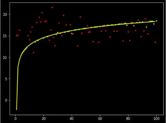

I was experimenting with curve_fit, RANSAC and stuff trying to learn the basics and there is one thing I don“t understand.
Why is R2 score negative here?

ransac = RANSACRegressor(base_estimator=LogarithmicRegression(), min_samples=int(n_sample/4), residual_threshold=0.7) ransac.fit(X, y)
inlier_mask = ransac.inlier_mask_ outlier_mask = np.logical_not(inlier_mask)
plt.scatter(X[inlier_mask], y[inlier_mask], color='yellowgreen', marker='.', label='Inliers') plt.scatter(X[outlier_mask], y[outlier_mask], color='r', marker='.', label='Outliers')
lineX = np.arange(X.min(), X.max())[:, np.newaxis] lineY = ransac.predict(lineX)
print("Estimated coefficients", ransac.estimator_.coef) print("Accuracy", ransac.estimator_.accuracy)
plt.plot(lineX, lineY, color='yellow', linewidth=2, label='RANSAC regressor')
plt.show()

After reading the RANSAC source code, I think I missinterpred the role of the score function. This is what I had to do:
def score(self, X_subset, y_subset):
        from sklearn.metrics import r2_score
        y_pred = self.predict(X_subset)
        self.accuracy = r2_score(y_pred, y_subset)
        return self.accuracy
